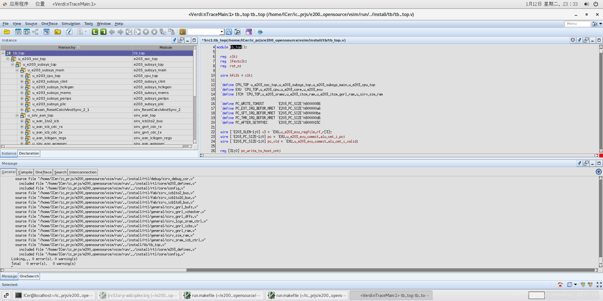

5.运行仿真
make install CORE=e203
make compile
make run_test
make wave
make compile
make run_test
make wave
